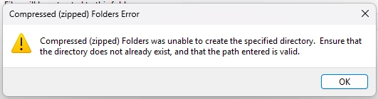

However, my computer will not let me unzip the file where it is located (it is within program files), and when I unzip it somewhere else, the protk_install_example can no longer access the files in protk_appls. I've verified that the C and C++ compilers are included in my version of Visual Studio 2022.

I tried to unzip the zipper folder "protk_install_example.zip" in the directory "C:\Program Files\PTC\Creo 12.4.0.0\Common Files\protoolkit\x86e_win64\obj\" (where the zip file is located) while running File Explorer as an admin, but that did not fix the issue. Could you help me with more specific steps on how to do what you are suggesting? I have attached a screenshot of the issue I am having.
If I extract the file to another folder, I get different errors because it can't access other protoolkit folders (the makefile uses relative references).

Hello, your problem seems unrelated to Creo API or Visual Studio version conflicts. You need to be able to unzip, locate and write files in the Creo installation directory. It sounds like insufficient file system permissions, drive space or too long/invalid path names (or security software) is the problem here.

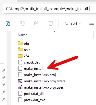

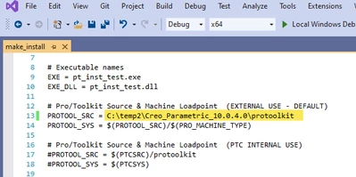

Give this a try:

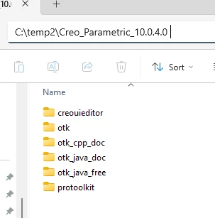

I have my toolkit related files temporarily installed in the location below.
I had to go into the 'make_install' file that is included in the VS project and edit the 'PROTOOL_SRC' variable by adding my toolkit path. FYI: It appears that spaces are not allowed in the path (so I added underscores where needed).
