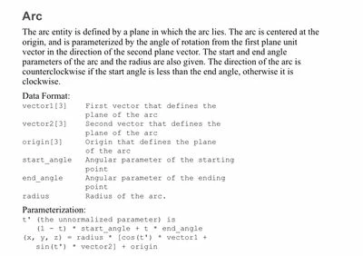

Hello, I would like to ask questions about the Creo toolkit. Currently, I need to use the Arc operation on the toolkit at work. This operation will require the input of relevant parameters, such as origin, start_angle, end_angle, radius. What I want to ask about is start_angle and end_angle. For the definition of the two parameters, please read the relevant documents. The above description is as follows: start_angle: Angular parameter of the starting point,
end_angle:Angular parameter of the ending point,
I would like to ask if you can provide more detailed explanations or examples, such as whether the value of this angle belongs to "degree" or "radian"? And from which point does the calculation of this angle start and end? The above

This could help
Use the function ProArcdataInit() to initialize an arc data structure. The
input arguments of this function are:
• vector1—Specifies the first vector of the arc coordinate system.
• vector2—Specifies the second vector of the arc coordinate system.
• origin—Specifies the center of the arc coordinate system
• start_angle—Specifies the starting angle (in radians) of the arc.
• end_angle —Specifies the end angle (in radians) of the arc.
• radius —Specifies the radius of the arc
