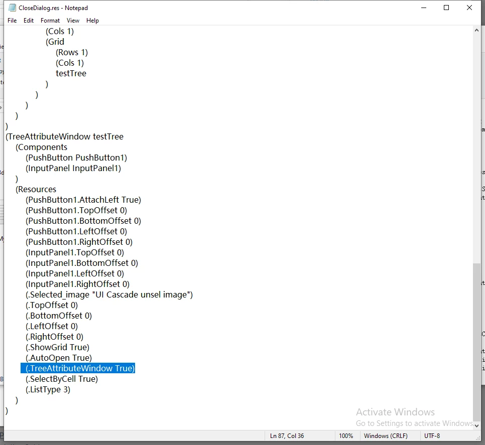

I am working with Creo 8. I would like to implement a dialog with tree view in it. The tree has 3 columns. I have spent few of hours trying to understand API to create and populate tree. But not able to figure how to do it. With C++ I wasn't even able to add node to tree. With C I could add node but not able to figure how to add column. If anyone has tried this already I would appreciate the help in from of sample code.

If you want add column in tree ui component.Set attribute [.TreeAttributeWindow] for [True]。
edit .res file with notepad,add attribute (.TreeAttributeWindow  True) in (TreeAttributeWindow testTree)

Hello, As suggested in accepted solution I modified my .res file to add following line (.<your_tree_view_name>TreeAttributeWindow  True) Replace <your_tree_view_name> with actual tree view name. Then I used ProToolkit API ProUITreeNodeInsert() to insert node in tree. It worked for me.
