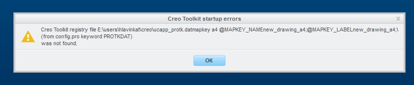

creo toolkit startup problem
can somebody help me to solve out this warning that appears when creo is launched?
Thnx.

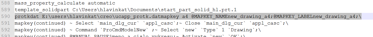

Oct 8, 2014 10:19 AM UTC
Tomas,
below you can see the source of the problem:
I modified your config.pro file and uploaded it. It contains two blocks of lines:
  • 1st block ... mapkeys, only
  • 2nd block .. other options
Note: There are two instances of a4 mapkey in the config.pro.
Martin Hanak

Oct 8, 2014 6:04 AM UTC
Tomas,
check your config.pro. It looks like lines containing PROTKDAT option and mapkey definition were merged into one line. You have to split them.
Maybe you can upload your config.pro ... I will check it.
Martin Hanak
Oct 8, 2014 8:56 AM UTC
Hi Martin, here is the config.pro
I just remamed it to .jpg since did not know how to upload files different from jpeg and video.
Thanx for your help
