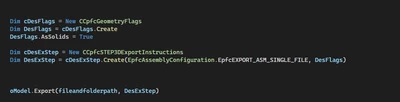

hi
this is how i solved it

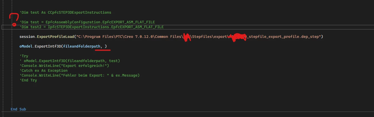

Hi
keep in mind that the VB API and Creo Toolkit at large is an automation of existing commands.
in that instead ExportIntf3d is the automation of exporting to step with a profile.
So you need to create a profile file and then give its path to the function.
what exactly do you not understand?

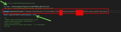

my problem is that i do not understand how to exactly code it. the profile i already have and i am retrieving it but then i do not know how to exactly paste it in the function.
red box shows the profile path
or is it correct there with the green ones, which does not work
