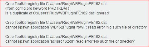

I'm trying to configure Creo2.0 with ANSYS16.2, but it doesn't work. I follow all the instructions on ANSYS CAD configuration manager and apparently the configuration is completed. But when I open CREO, I get an error: Creo toolkit registry file C:\Users.....\WBPluginPE162.dat: cannot spawn application.....No such file or directory'. I need help please

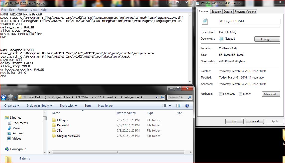

WBPluginPE162.dat files is in your startup directory, therefore you do not need PROTKDAT line in your config.pro.
2.]
Open WBPluginPE162.dat on Notepad and check/correct paths inside it.

as Martin mentioned and from your picture it looks like the path are not correct and it seems you have duplicate dat files.
Here I figured out, that the $ANSYS_PROEWF_VER162 variables in the WBPlugInPE.dat are not filled with the correct value so I replaced the variable in the EXEC_FILE and TEXT_DIR path line with the value which is the name of the directory "ProE".

I opened WBPluginPE162.dat, but I don't really know how to correct the paths. Here's the dat file. I don't quite understand how to replace the variables in the path with the name of the directory "ProE". what is the directory "ProE"?  Thanks again.
Mar 4, 2016 9:06 PM UTC
there is no variable in your WBPluginPE162.dat file.
Your picture tells me that C:\Program Files\Ansys Inc\v162\aisol\CADIntegration\ProE directory does not exist. Unfortunatelly I do not know why. Maybe you have installed wrong "Creo-Ansys interface" ?

Thanks a lot Martin, do you suggest I should reinstall Ansys?
