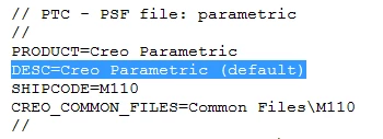

Creo2 PSF Descriptions not showing up in license borrow selection
We have 5 different .bat / .psf combinations for launching Creo 2 M090. They are used for different license configurations.
I was trying to borrow a license and the startup configurations all show Creo Default C Drive. I got stuck there because I didn't want to pick the wrong one and get stuck with a borrowed license that I can't return (can anyone detect a sore spot?).
I understood that it would show the DESC value in the .psf files, but it is not showing them

May 29, 2014 2:04 PM UTC
never mind. The knucklehead that made the .psf files had 2 DESC lines. I only saw the first one (where it was supposed to be) and wasn't looking for multiples.

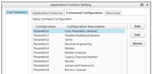

May 29, 2014 3:00 PM UTC
They shouldn't all say "Creo Default". This has to be configured when the software is installed or revised.
[cid:image001.png@01CF7B14.143650A0]
[cid:image002.png@01CF7B14.143650A0]

May 29, 2014 3:11 PM UTC
Also, you can change manually in the psf:
[cid:image003.png@01CF7B26.5D5E2B60]

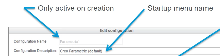

BK
May 29, 2014 3:29 PM UTC
Ok, yes you could edit the files manually.
But, if you're trying to set up for a scripted install for all your machines, you don't want to do that.
You want the information to be in the xml file called from the install command.
"C:\ptc\Staging_Folder\Creo 2.0-m090\Creo 2.0-m090 software\setup.exe" -xml "C:\ptc\Staging_Folder\Creo 2.0-m090\new_install\pma.p.xml"
Personally I don't want to futz around inside these files to change things. I rather do it right to begin with.
