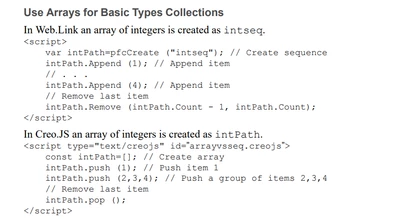

9-Granite
Dec 22, 2025 5:00 PM UTC
Hi @RandyJones
Thanks for the Quick Reply.
I missed those portion in CreoJS user guide. Also in Page 18 they have give example for Array in CreoJS. Please see the below image
Now the below code is working for me and i can be able to Display message in message log.
function printMsg(msg) {
const strTest=[];
strTest.push (msg);
try {
globalSession.UIDisplayMessage("usermsg.txt", "USER %0s", strTest);
} catch (e) {}
