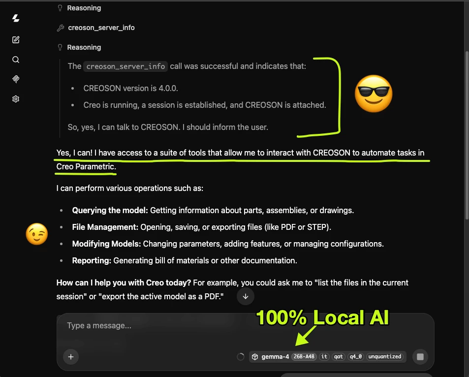

Here is a new experiment running on a mid-2017 MacBook Pro with a 100% Local AI (Gemma4) talking to a remote Windows 11 Machine that has a CREOSON MCP Endpoint (in beta).
This was just a simple connection test - asked it if it can see the CREOSON MCP endpoint?  And this was the response.
The cool thing about this…. the Local AI knows “nothing” about Creo Parametric before this interaction.  The MCP provided enough context to give the Local AI a bit of courage. 🤣
NOTE: I do not recommend running a Local AI on a mid-2017 MacBook Pro. 🙄  But it definitely works.

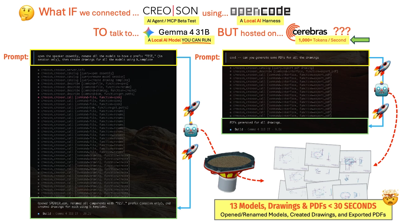

I have fielded quite a few questions regarding Local AI and how to do that effectively.
My “Go To” Answer on this comes down to three (3) factors:
  1. The Model - you need a language model capable of contextualizing and reasoning your content
  2. The Harness - the glue that orchestrates your intent, your skills, language model, MCP endpoints
  3. Inference Speed - the hardware required to run your language model (capacity and speed)
Those are (IMHO) the most important - inference runtime/engine for the model is another factor (geeky stuff 🤓).
I wanted to show more than “Claude Code” as an interface to Creo Parametric (everyone does that, figured some would appreciate a radically different approach).   So I picked this stack as a test.
  1. Model - Gemma 4 31B (31B indicates the size of the model 31-BILLION Parameters)
  2. Harness - OpenCode (an Open Source harness, like Claude Code or others)
  3. Inference Speed - Cerebras (running the exact same Gemma 4 31B you can run locally)
Cerebras hosts the Gemma 4 31B Model, the OpenCode Harness knows how to talk to it via an Cerebras API Key, and OpenCode also knows where the CREOSON MCP is located (a Win11 Machine on my local network) - oh.. OpenCode is running on my MacBook Pro - orchestrating ALL this traffic.
The reason I chose Cerebras is simple:
  • Cerebras has the fastest commercially available AI Inference on the planet,
  • The Local AI Model I wanted to test (Gemma 4 31B) was running on the Cerebras platform,
  • Everything else was local to my computer/network
So this setup enabled me to show how important inference is in a relevant engineering example. Open a model, change all the names to have a prefix, generate drawings for every model, ultimately generate all the PDFs. Here was the result:
So - this is literally one of those pinch my-self days because it did not seem real.  We provided a few things (very quickly).
My instructions to Gemma 4 31B via OpenCode, were properly contextualized with the CREOSON Agent Skills and orchestrated to CREOSON MCP running on another laptop connected to Creo Parametric from my MacBook Pro. (a cigarette worthy experience).
The point of this post is simple.  AI is getting REALLY GOOD, REALLY CHEAP, and REALLY CAPABLE.  Local AI specifically will be one of the most important factors in Engineering - this will require good models, good harnesses, and good hardware.
The next year will be explosive for AI in engineering - the Hardware is getting bigger, the models are getting smaller, and the orchestration of all this is getting easier. You are going to have many choices.
Hang on.. this is going to be fun!

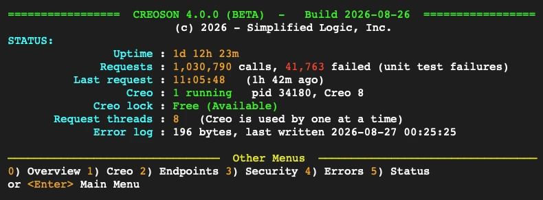

Pro-Tip…  make sure your infrastructure is ready to support your crazy AI ideas (at scale).
This is a screenshot of a very long set of functional unit tests across a range of CREOSON function groups/use cases.  Basically, this was running on a remote Windows 11 computer, orchestrated from my Mac.  No Crashes, No Errors, No Resets, Creo Parametric (v8) just grinding away for ~1.5 days executing 1M+ transactions. 🙌

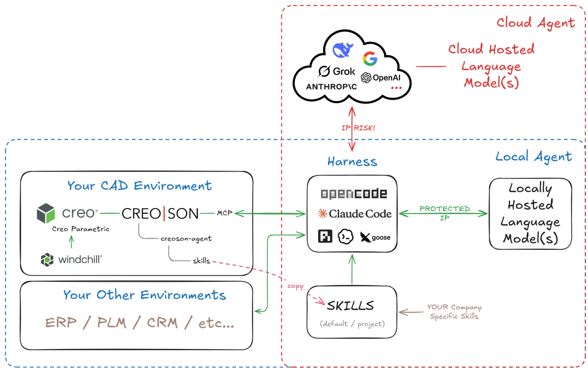

OK - pushing the envelope a bit on this experiment… but it is looking very good and useful.
One of the biggest “unknowns” with AI is in demos that have no description of “how” they got there.  The “how” currently is hard.  Just telling someone “create a skill” for AI to use is often the wrong advice when most people don’t understand the moving pieces to make all this work.
As I have said before “how?!” is the frustrating hard part.  IF that is understandable and easy to execute, then AI becomes an enabler not a barrier to execution.   Today's experiment was on how to make “how?!” easier for automating Creo Parametric via CREOSON.
CREOSON AI Skill → Company (proprietary) Skill
The idea was simple, have a CREOSON Skill that enables an AI Agent to:
  • interview a user, to
  • capture the expected steps/process/verifications achieve a goal, then
  • write a NEW Company Skill to support internal AI workflows/automations with Creo Parametric.
Why is this important?
Automating Creo Parametric is a “personal” thing for a company. Seemingly routine things like exporting PDFs may have entire sequences of operations that should occur before/after that trivial operation; often required by company standards or customer specific expectations.  A nice example of “grunt” work that may vary depending on needs.
THIS is why skills are important.  Skills enable you to document processes, contextually leverage, and apply them.
This experiment was to show that a CREOSON Skill could help generate a company-proprietary skill for automating Creo Parametric … folding in CREOSON Skills as context to further accelerate the automation process (leverage what is in-hand and available vs writing bespoke skills that repeat same instructions over and over).
FINAL NOTE: Proprietary Skills = Intellectual Property → Prioritize Local AI!
So there is a risk and an opportunity when creating skills that document company processes that will be processed by AI.
  • Commercial AI platforms “crave” this information - your skills, interactions, and data provide high-quality insights for “how” specific things are done by you.  If your company is not concerned about this, keep going!
  • Local AI hosted platforms - is where your entire stack is LOCAL to your environment and remain in your control. Specifically, your data, transactions, skills, etc. all route through your AI Harness, Language Model, Skills, and MCP endpoints (CREOSON ↔ Creo Parametric or elsewhere).
The next release of CREOSON (which is currently in beta) will expand on the “how” to do all this either in the cloud or locally in your company environment.  Skills are very important to the process, we are trying to make them easier.

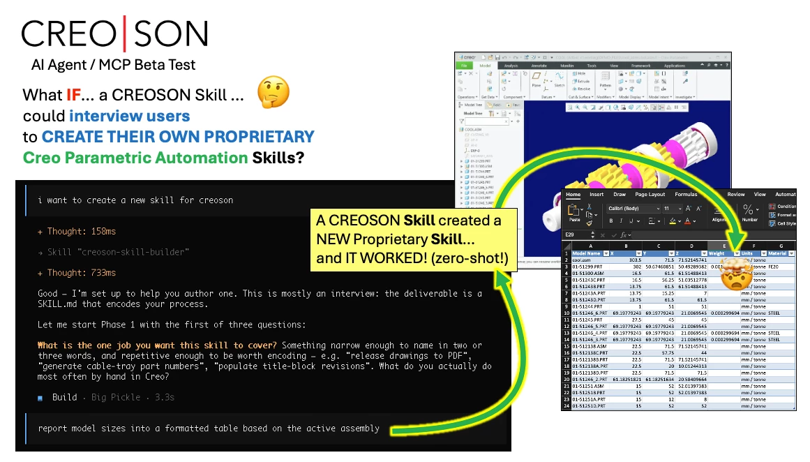

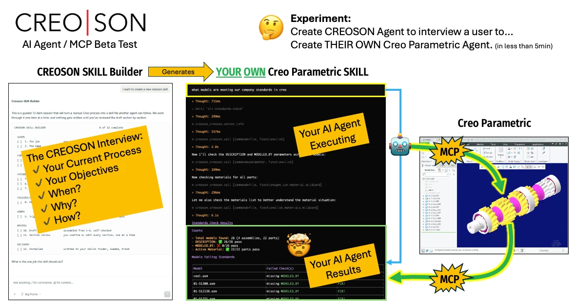

Here is a new CREOSON Skills and Agent experiment for creating YOUR OWN Creo Parametric AI Agents and deploying them.  This is currently in Beta Testing for the next CREOSON release.  Much to consider, but all the groundwork for enabling MCP is being confirmed by experiments like this.
We are working on a AI Skill that interviews you to:
  • Understand your current process,
  • Understand your objectives,
  • Automatically plan the Creo Automation,
  • Verify that it can be done (CREOSON functions and process), then...
  • BUILDS your New Automation SKILL for you … your own Creo Parametric AI Agent!
The first experiment showed that a NEW Creo Parametric AI Agent could be created in less than 5-minutes!
Did it work?  Yes! - zero-shot, first try. 😎
The CREOSON Skill Builder is not limited to CREOSON / Creo Parametric Interactions via MCP.
MCP is becoming ubiquitous as an interface for connecting multiple applications, systems, and environments together.
Soooo…. It is completely possible to use the CREOSON Skill Builder to dial-in Creo Parametric while also including other systems like ERP, PLM, CRM, etc. via their MCP connections to build out enterprise automation workflows.
This experiment will continue… it is looking really good so far.  Here is a higher resolution of the custom Agent execution:
Is this perfect? NO, Absolutely NOT.
Can it do everything?  NO, API limitations are always a thing. (CREOSON enables a LOT!)
Will it help companies create their own AI Custom Agents for Creo Parametric?  ABSOLUTELY!
Can other systems be folded into the process with Creo Parametric?  100%!
More to come as we continue to develop and learn, if you have any interest in this you can sign up to be a Beta Tester at https://creoson.com
Reach out if you have an automation pain or problem that you want to discuss!

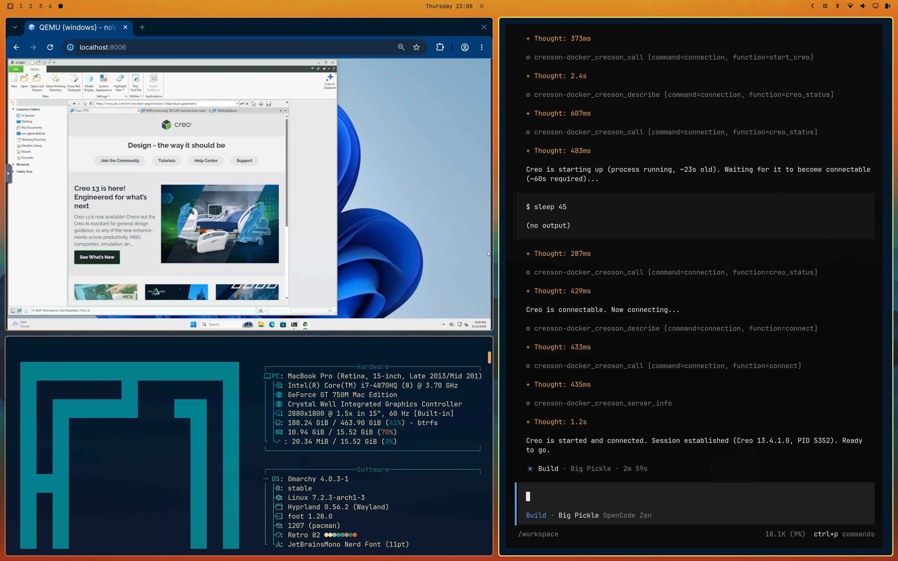

The following image is only intended to show an extreme example that worked.  Kind of the worst case (complex setup) and best case (more secure) at the same time. The objective was to isolate the moving pieces through containerization.  Specifically using Docker - prove concepts, connectivity, and basic functionality only:
  • Windows Container contains:
    • Creo Parametric (13)
    • CREOSON Server (beta) w/ MCP Endpoint
  • Linux Container contains:
    • AI Harness (OpenCode as a test)
    • CREOSON Skills
  • AI Language Model (remote for this example):
    • Used Cloud Endpoint due to old computer w/ limited GPU resources
    • Containerized…. totally possible!
Just for kicks - this was all done on Linux (Omarchy) … because it is cool!
What you are looking at:
CREOSON is in Windows Container with Creo Parametric.  Creo Parametric was started in the Windows Container via CREOSON MCP from a separate Linux Container that contained the AI Harness and the CREOSON Skills.  The AI Harness Container was talking to a Language Model in the cloud (again, limited resources on an old laptop; BUT that Langauge Model could be another isolated Container).
The result?  For a proof of concept that proves some fundamental improvements in security.. validated.
Would I recommend this configuration for Local AI??   Isolating the AI Harness and Language Model is probably the most important thing to pay attention to initially.  The Creo Parametric aspects would need further testing (this was a bespoke capability demonstration for Windows container with Creo Parametric running in it  - a Virtual Machine would be more logical starting point).
Hope you find this interesting.   A LOT of people are “talking” about AI… few are actually “doing it”.   So if you are interested in moving beyond discussions into actual work with AI … DM me or reach out.

The current release provides an JSON interface with highly optimized user-relatable functions that can be called from any language (Python is the most popular via CREOPYSON).
CREOSON 4.0 is nearing release.  The new CREOSON Server is more portable, stable, and much easier to configure and align to your local or enterprise environments.  Specifically, the CREOSON Server can enable a secure Model Context Protocol (MCP) endpoint, and will ship with CREOSON Skills to support your own SI/AI Agents either using either Local or Cloud Small/Large Language Models.
