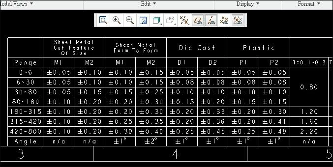

On this example image from a .drw :
Use this function : c.note_list(get_expanded=True)
I can read the title, e.g. "Sheet Metal . . .", "M1", "M2" but not the table contents, e.g. "+-0.05","+-0.10", etc.
What I have read is like this:

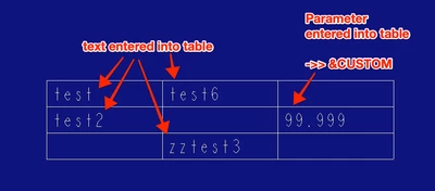

When I ran a test using your approach (obviously you are using the CREOPYSON library) - it seems to work... which makes me wonder how your table values are put into the table.  For example:
Here is the same call in JavasScript that was ran in the CREOSON Playground:

 As you can see - it picked up on all the data and reported the values.  But one of the values is being reported as a reference to the Parameter "CUSTOM" - so this would need to be obtained as a second step.
What is the type of data in your table that is not being reported?

Now I know what's wrong:
c.note_list(get_expanded=True) # does not expend 'encoded' items, that's the reason!!!
 ... snip ...
 {'name': 'Note_200', 'encoded': True},
 {'name': 'Note_201', 'encoded': True},
 {'name': 'Note_202', 'encoded': False, 'value_expanded': '0.80'},
 {'name': 'Note_203', 'encoded': False, 'value_expanded': '0.60'},
 ... snip ...
So c.note_list() can read tables but the results need further treatments.
