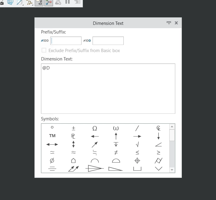

Hi Guys
can we add custom symbol in Dimension Text?
if any one knows pls let me know.

Vladimir,
the question is related to Creo Toolkit...

You must enter the escape sequence in the text.
First do it manually, create a note with the symbol, next get the note via toolkit and check the note text.
