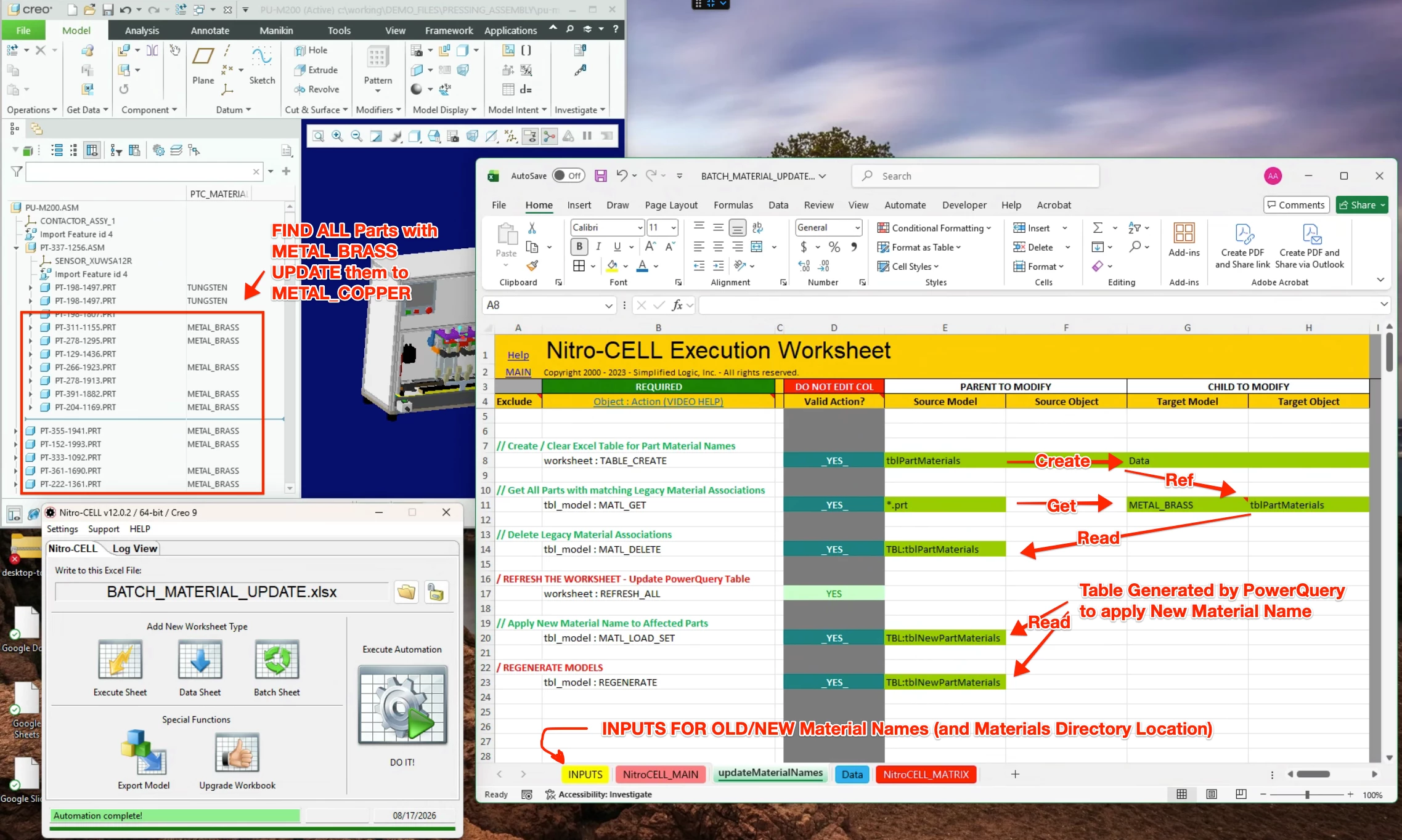

Nitro-CELL Automation accomplishes your goal.
The Good News - The attached Excel Worksheet (BATCH_MATERIAL_REPLACE.xlsx) has everything you need (Nitro-CELL commands and process).
To Get RUNNING:
You just need to download Nitro-CELL and request a FREE License (you need JLINK installed for this to work - also FREE).  Recommend also getting the Excel Add-In to enable the Nitro-CELL command tooltips on the commands and options in Excel so you can better follow.
Then
  1. Launch Nitro-CELL,
  2. Select the Workbook in Nitro-CELL,
  3. Load your Assembly/Parts in Creo, and
  4. Press the “Do It!” Button.
That is it.

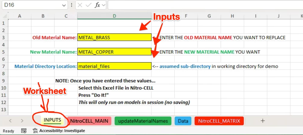

You can enter your OLD and NEW Material Names (including the directory where your material files are located) like so.
The Nitro-CELL automation will process ALL the part models currently in session and basically does this:
  1. This finds ALL parts with your OLD Material File Name in session,
  2. Deletes the OLD Material Names from those files
  3. Sets the NEW Material Name to those files.

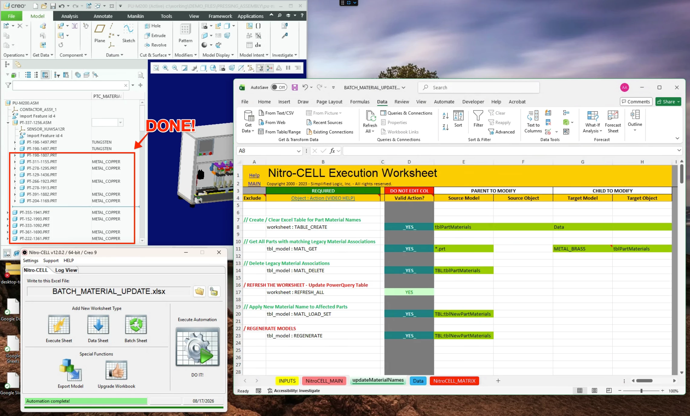

  4. Regenerates all the updated models. (Note: you will still need a Ctrl-G to see your Model Tree Update like shown)
  5. DONE! (in a few seconds)
Try with with some small assemblies to prove it is working -- then you can do more. (or extend the workbook to do other things like save the files after they are updated, or do more sophisticated batching of more files).  All the commands are available to you in the FREE License.
Here is an example I ran with the automation example workbook. (I had a sub-directory where my material files were located - so in your case the new material name file is just a copy of the old file - with the new name to reference/use).
And the Result after running.
I think this solves the pain you are trying to avoid.  The approach is not the one you were likely expecting, but it seems to address the need.
