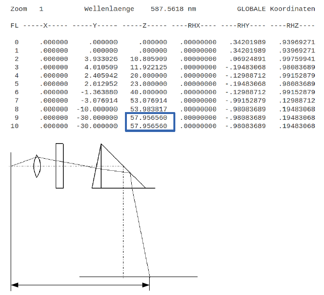

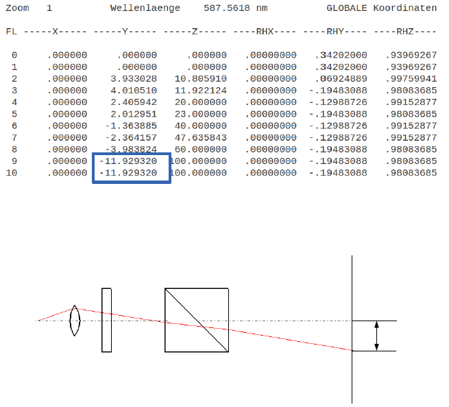

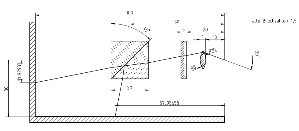

One of our customers compared the results of SMARTOptics with a professional optic calculator.
  Y Z
SMARTOptics -11.92933 57.95658
Optics calculator -11.929320 57.956560
SMARTOptics results in Creo Parametric:
Optics calculator:
