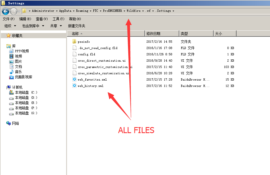

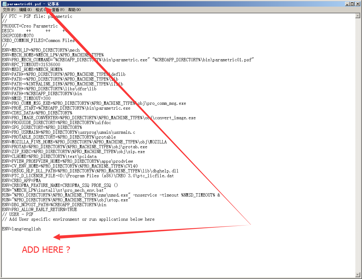

I also found that the custom Cr4 was also loaded into the CR3, and the contents of the navigation bar.
Specifically how to do, you can separate them? Thank you ~!

1.] create following directories
C:\PTC\PTC_WF_ROOT_CR3
C:\PTC\PTC_WF_ROOT_CR4
2.] edit parametric.psf file in CR3 and CR4 (put ENV lines at the end of file)
In CR3:
ENV=PTC_WF_ROOT=C:\PTC\PTC_WF_ROOT_CR3
In CR4:
ENV=PTC_WF_ROOT=C:\PTC\PTC_WF_ROOT_CR4
3.] launch CR3, CR4
You will see that files previously saved into %APPDATA%\PTC directory are now saved into directories mentioned in step 1.
4.] now you can remove %APPDATA%\PTC directory
