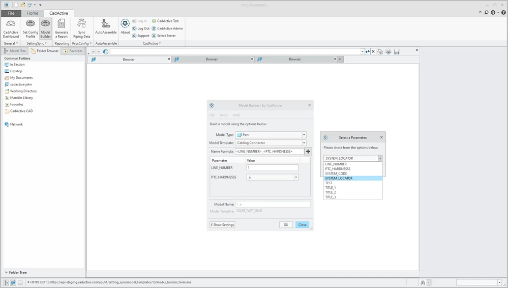

As Remy mentioned, you will need the Pro or Object Toolkit APIs to create this which adds cost and time.
My company has developed something very similar Model Builder already that may be similar to what you're looking for. It creates a PRT/ASM/DRW based off certain attributes, which are defined and standardized by administrators in our database. You can then define a name formula which will name it according to the values of certain parameters also defined by an administrator.
Let me know if that is close to what you're looking for!
