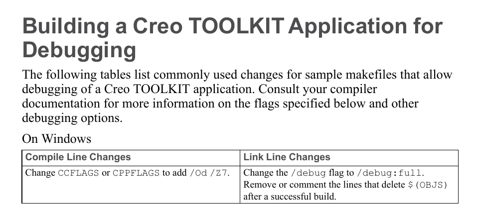

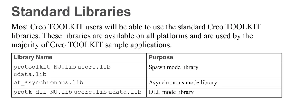

In case toolkit project, I think, no need to change flag to /MD.
For Release DLLs need to use "Standard libraries" /MT and remove flags for debugging (see below).
From Creo 9 toolkit documentation:

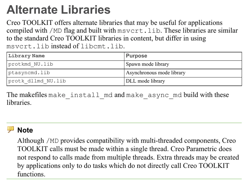

We have found similar to you, and for our projects we need to use Multi-threaded DLL (/MD) for the Debug configuration to avoid LNK2038 build issues.
An issue that is awkward that we have to manage to keep on top of the build issues, but we have never found an ideal resolution or an explanation, so I am interested in hearing other peoples views on this.
