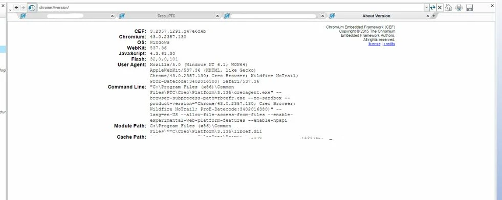

Hello all,
We are trying to access a web-page.
But it is having compatibility issues with Chromium browser. (Attached snip of Chromium browser details)
How to debug embedded chromium browser in Creo 4 as developer tool?
Please comment.

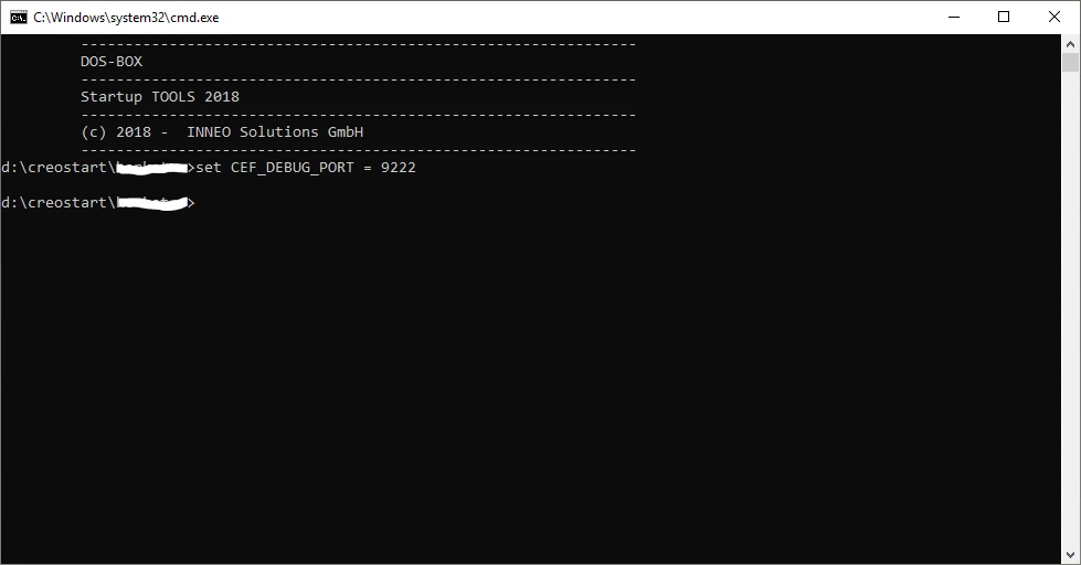

Has anybody found a solution for this problem? I myself also try to debug JavaScript code, so far with no success.
There is a support article saying that you should debug using a standalone browser. For this the article says to set the environment variable CEF_DEBUG_PORT to a port and access this via localhost in the browser.
This approach has so far been unsuccessful for me.
Any ideas how to fix this?

If you have access to a support base, take a look
https://www.ptc.com/en/support/article?n=CS273018
In shot
  1. Make sure Chromium browser is chosen as embedded browser type in set windows_browser_type=chromium_browser in config.pro
  1. Set environment variable
set CEF_DEBUG_PORT=9222
  1. Then using another standalone Chrome browser, browse to this address on the same machine:
http://localhost:<port specified in env variable>/

Thanks for the quick reply and help!
Unfortunately this approach is not working.
I open the system window in Creo and enter the command (see screenshot). There is no indication that something happens afterwards.
When I open Chrom and try to access localhost:9222 I get a message that localhost has refused the connection (ERR_CONNECTION_REFUSED).
Any idea why this happens?
