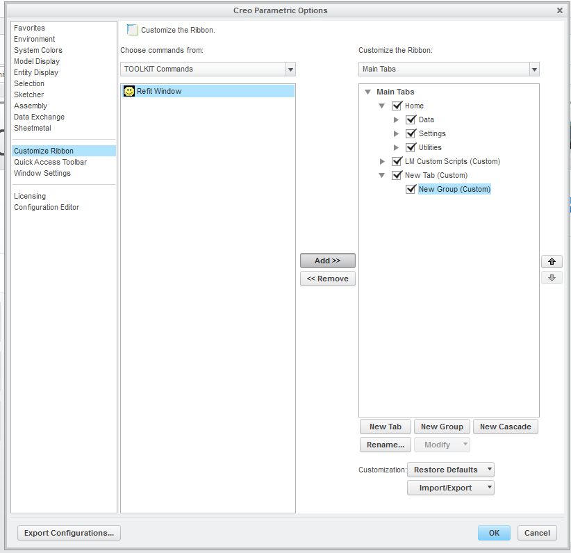

To clarify, I am trying to add a simple 'refit' function to my Toolkit commands, and then add that script to my ribbon. My script compiles without errors... but I really think I'm just doing something simple incorrectly.

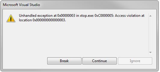

I can compile this into a DLL, but when I add my "Refit Window" command to the toolbar, the error I recieve simply shuts down Creo, regardless of where I place my breakpoints. This is why I thought maybe I had something set up incorrectly... but it may just be my code?
I looked up this error, and it seems to be related to having multiple thread processes... but I didn't think I was using multiple threads because I never did a ProEngineerMultithreadModeEnable()....
Any advice or experience you guys may have would be greatly appreciated!!
