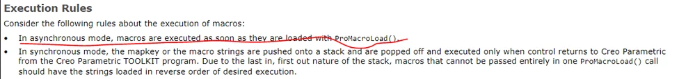

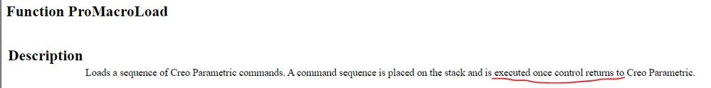

You should try a simple experiment - start 'Find' dialog (CTRL+F) and call your mapkey. Most likely, the active dialog box would close...
Generally, if you are calling mapkeys as dialog actions you would be better off to use asynchronous mode for pro/toolkit app.
