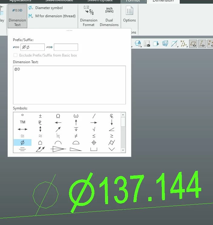

I have set following settings:
Model Properties /Detail option
  default_annotation_font arialn.ttf
  symbol_font ISO
same settings in drawing properties

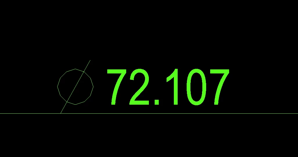

All symbol come in arialn.ttf but only the diameter symbol (by pressing button add diameter symbol to dimension) stays in old legacy mode (see picture - only lines no ttf font)
Strange thing is  - when i manually add the diamter symbol as prefix it is correct (see second picture)
How can I fix this?

I guess that the old diameter symbol was added to dimension manually.
