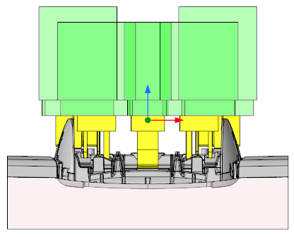

For example we would like to separate the electrode base from any electrode geometry.
Electrode geometry: yellow (RGB-code 255/255/0)
Electrode base: green with transparency (RGB-code 0/255/0; Transparency 80%)

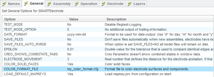

At first we need to add an empty text file to the configuration. For example 'my_color_format.cfg'. Now the file should be opened in any text editor to add the rules for the coloration. The color format file needs following information in tab-delimited columns:

1.
Open options UI and set file name

Now let's use the STEP-export configuration from Did you know about STEP/IGES-export for CAM‌ and import one of the files in Creo Parametric again.
Gosh!? What happended here? - All surface colors are gone in the export.
After some investigation it's clear that some Creo options need specific settings.
step_appearance_layers_groups=yes should be used with step_export_format=ap203_is*.
step_appearance_layers_groups=no should be used with step_export_format=ap214_is.
After a 2nd run of the export functionality the import looks like expected.
