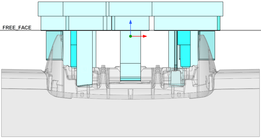

The datum plane FREE_FACE is the default plane for the creation of the electrode base. The datum plane is defined in operation UI and has an offset from the bounding box of the workpiece in +Z direction. The datum plane is copied into every new electrode and therefore all electrodes have the same height over the workpiece if the automatic processing is used:
All electrodes use default FREE_FACE

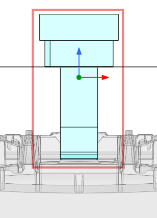

For the highlighted electrode it makes sense to place the base deeper in the workpiece to minimize the required size of the blank:
Electrode which base position should be changed
This can be done in two different ways:

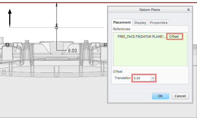

Redefine datum plane FREE_FACE in electrode
1. Select FREE_FACE and start redefinition Select FREE_FACE and redefine
2.
Change constraint type from Through to Offset and edit translation value
Confirm feature definition
Set offset value
3. Result Resulting base
