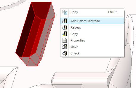

In some cases a simple electrode geometry can be extracted easily. For these cases, SMARTElectrode offers a quick function. After selection of the burn-faces select Add Smart Electrode from the context menu:
Add Smart Electrode command in context menu

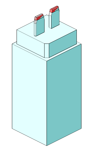

The software performs the necessary steps as far as possible automatically:
1. Creating a new model from template. Resulting new model
2. Copying selected surfaces. Result of copying selected surfaces
3. Cutting out geometry. Result of cutout feature
4. Adding an offset to top surface Expanded top surface
5.
Attach geometry. Connect solid with base.
Geometry connected to FREE_FACE
6.
Selecting an appropriate size from the blank list.
Creating the base.
Resulting base

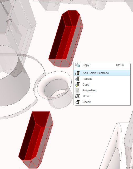

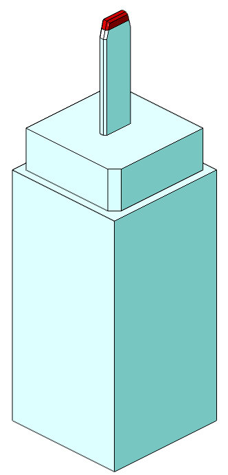

This procedure also works with multiple selected surface sets:
Multiple selected surface setsResulting base for multiple surface sets
