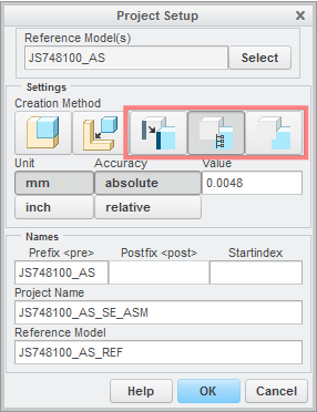

In many companies, electrode designers may not change released models of the tool design, but often a simplification of these models is desirably. The interactive creation of reference models is time consuming and a boring, repetitive task. SMARTElectrode provides a functionality to create a reference model in new assemblies. The reference model is a copy of the original models - like reference model in mold and Creo NC - and can be created in different ways:
  • Copy geometry and solidify
  • Inheritance
  • Merge
If the reference model is created from an assembly, all selected models will be copied into the reference model.

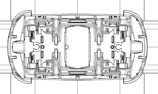

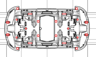

Simplify and prepare
Inside the reference models all changes can be done without modifying original models. Ejectors and cooling can be suppressed (inheritance only) or removed, surfaces can be collected for easier electrode extraction and color codes can be used to separate different electrodes.
Reference model before and after suppressing ejector pins and inserts.

  • SET_COPY_GEOM_INDEPENDENT - create reference model with manual update (=yes).
  • REFERENCE_METHOD - method to be used for assembly creation (=3 - inheritance):
    2016-09-14_007.pngUse current model (for assemblies).
    2016-09-14_008.pngUse original models.
    2016-09-14_009.pngUse copy-geom and solidify for reference model.
    2016-09-14_010.pngUse inheritance feature for reference model.
    2016-09-14_011.pngUse merge for reference model.
