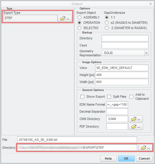

1. Open electrode assembly Current electrode assembly
2. Open Output UI Command Output in ribbon UI
3.
  • Browse list of export types to load template and options
  • Edit file-name if necessary
  • Set output directory
  • Confirm with OK
Output UI
4.

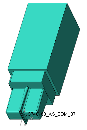

All electrode models will be saved as STEP-file to selected directory. SMARTElectrode will use the csys defined in configuration as reference for the export.
Imported STEP-file
How to customize the export?
How to ouput data to a data exchange directory with a mapped drive letter?
Open export options file export.cfg in configuration\export\STEP and edit the value for SE_EXPORT_DEFAULT_DIR.
Export options to edit  Edited export options  New option value in Output UI
SMARTElectrode will now save all step-files to the new directory.
