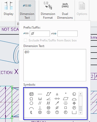

i would like to ask you for help. I would like to modify dimensions symbols. In drawing, when you click on dimension and want to modify dimension text. There is symbol pallet. (diameter, +/-.) I would like to edit these smybols. Can you help me how to do it? I think there should some file where these symbols are saved,  i don´t know where.
Thank You for help

De/compile font in Common Files\x86e_win64\text\usascii\special.fnt
As far I remember this is what you are looking for.
Found in 'Common Files/text/usascii/stroked_symbol_asme.src'
Position 317.2
d 16, 22
d 0, 30
# diameter
" code 8960 2300"
width 28
Found in 'Common Files/text/usascii/stroked_symbol_iso.src'
Position 321.6
d 16, 22
d 0, 30
# ISO diameter
" code 8960 2300"
width 18

symbols shown in dialog window are related to detail option SYMBOL_FONT. You cannot edit them in a simple way, because their definition is saved in TTF or Creo font files.

yes, i know about this symbol_font setting. Unfortunately we need to go deeper. We already made changes to the ttf font we are using for new templates. If its ttf i can modify it simple (we know how how) if its creo font file i´m not sure we change it (we can try). Can you please give me the path where these symbole are located?

simply search Creo installation directory tree for files with ttf extension. If the filename contains ansi string then you hit the target. More details tomorrow.

Perfect!! Thank You
