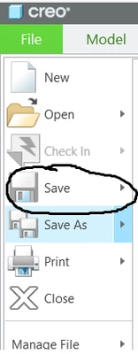

i want to disable the "File->Save" the "Save" Option through toolkit. if any one knows please help

no, i just want to disable the save option once the model opens. i've no idea about to disable the "Save" Option.

Aravind9813-AquamarineAuthor
May 30, 2024
no, my requirement is, once the model opens this default save option should be disable, same like as "check in" Option.

That would mean to configure the interface (greyed out) by you, as far I know, you can’t. Save, is for the current model, so you can decide (based on the model handle)  to allow save, or abort, I don’t see a difference, just write something to the message area that you don’t allow to save the model  for whatever reason.
Your model could contain external data for that, just check this during this callback and decide.
