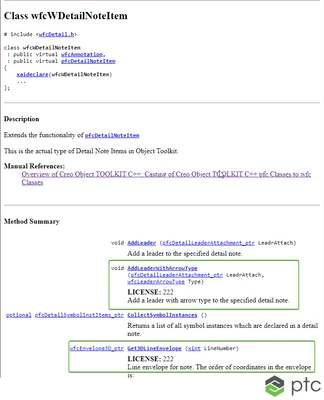

Generally speaking accessing 3D annotations and MBD at large is under license -222. This can come as a surprise and yet the information is delivered in the documentation.
For example:
To ensure your request is addressed can share a screencapture of the exception thrown?

This is the exception that I have obtained.
Aug 5, 2022 9:03 AM UTC
Thank you for clarifying the exception.
This indeed means that the method needs the license. It is mandatory.
