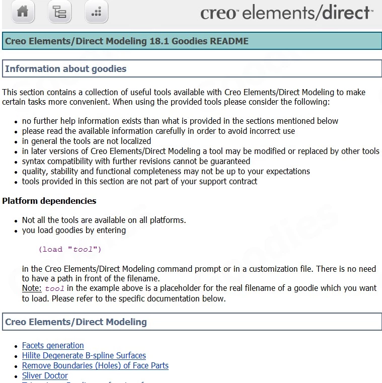

The ReadMe file for the Goodies.dll states: "For more information, please see Online Help "Documentation for advanced users""
I haven't found anything so far. Suggestions - where to look, or how to load?

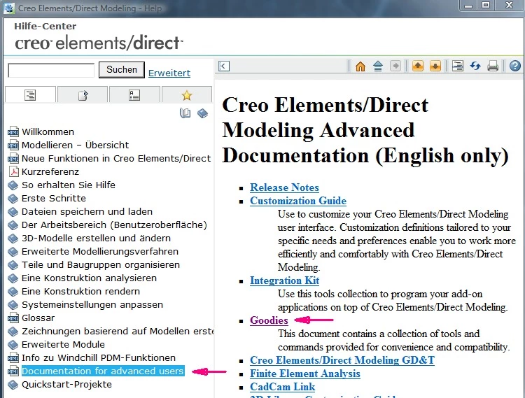

There is no "Documentation for advanced users" in the help and the goodies also not work to my knowledge.

No, I'm using the full edition. I used to have goodies back on my HPUX machine many years ago, and in the NT ported version. Recently renewed but haven't found documentation to load the DLL and the readme file is as described, pretty thin.

Strange that you do not find the "Documentation for advanced users"
Have you looked there?
