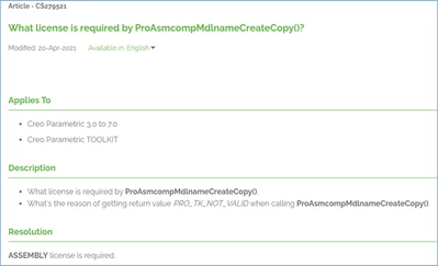

Does it need special license for function ProAsmcompCreateCopy ?
Recently I try to study the function ProAsmcompCreateCopy by C language,
and always gotten the return of -26. After checking the menu, -26 means
PRO_TK_NOT_VALID   Required license not found.
so would like to know does it need other special license for this function? thanks.
Jun 2, 2021 5:22 AM UTC
Thanks.  I found the below information for reference.
May 21, 2021 1:14 PM UTC
It should not require any additional license.
But since this is deprecated, try to use the new function ProAsmcompMdlnameCreateCopy
Bryan_Chen1-VisitorAuthorAnswer
