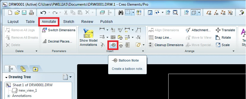

Hi All,
WF 5.0 M200. Does anyone know if there is a way in Pro/TOOLKIT to access and create a predefined note that is available in the UI? Or do I have to re-create the functionality? Additionally, does anyone know how to access the settings in the .dtl file?

Hi all,
Patrick,
Balloon symbols with notes - you'll have to write the code - there are'copy/paste' examples in the user manual. Detail configuration file - there is no dedicated API. From configopt 'drawing_setup_file' and 'prodtl_setup_dir'you'll have to get the current file name, if any.Open itfor readingand tokenize onwhitespaces,store results instd::map to make yourlife easier, get your settings...
HIH.
Feliks.
CORRECTION: WF5, late maintenance cuts - new functions were added:
ProDrawingSetupOptionGet and ProDrawingSetupOptionSet. No reason to parse dtl settings file manually anymore.
Feliks.
