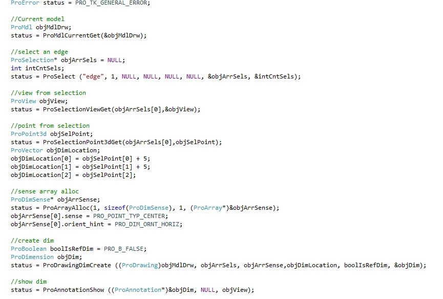

Hello
Created new dimension in drawing using toolkit, but it's location is not proper.
Attached is code snippet along with what is the issue in drawing dimension text location.
Feel free to ask for any clarification or more details.
Regards
Ketan

2-Explorer
Sep 14, 2018 4:16 AM UTC
Attaching code snippet for dimension creation I have used

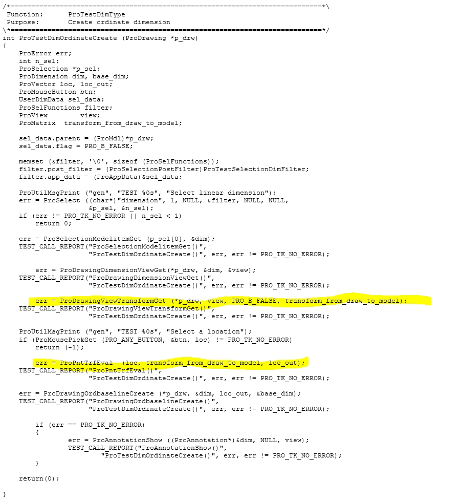

FV_01
Sep 19, 2018 2:11 PM UTC
Hi all,
Ketan, transformation from model to view coordinates was left out. Take a look at TestDim.c in toolkit examples.dim.png

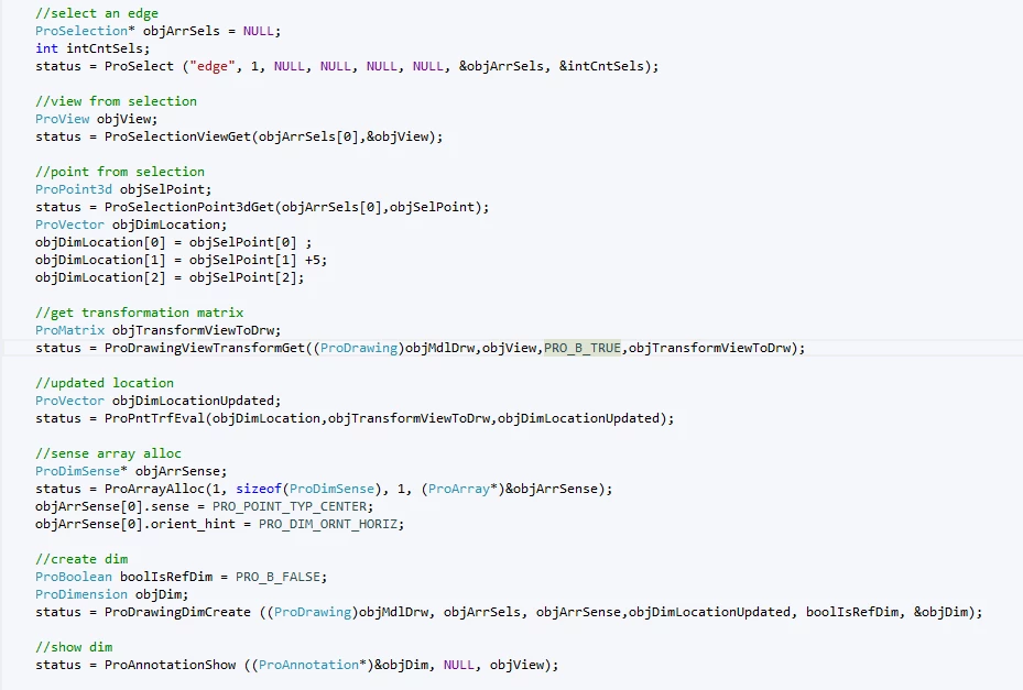

2-Explorer
Sep 24, 2018 4:29 AM UTC
I tried same as per attachment , but it did not work. 😞
Could you please suggest what I did is correct or not?
