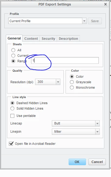

Task no.1 for you: create series of mapkeys which save sheet no.1 into PDF, sheet no.2 into PDF, ...and so on (in PDF export dialog you can enter sheet number).

In the export dialog box was i supposed to enter the sheet no. in the circled region?

Yes, you are right !
