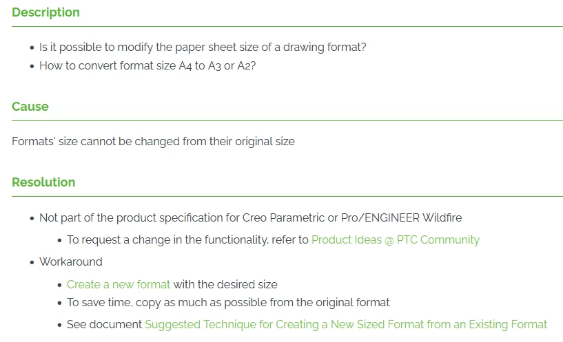

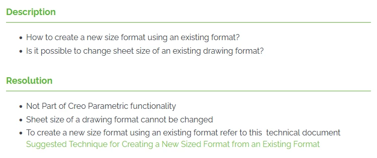

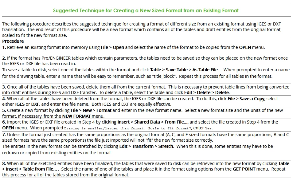

Basically you're stuck with copying information from the old format and pasting it into the now one.  From the PTC knowledge base:
https://www.ptc.com/en/support/article/cs16855
https://www.ptc.com/en/support/article/cs29321
http://support.ptc.com/cs/cs_26/howto/fom_size/fom_size.htm
