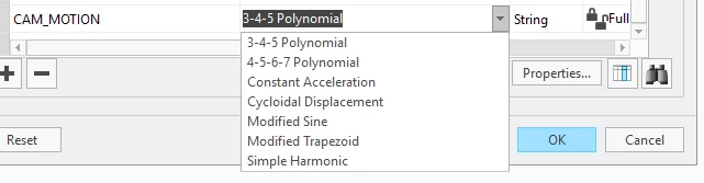

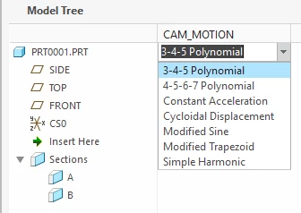

    If you're talking about this dialog, then I think you're out of luck.
    The only places I've seen the drop down behavior work is on the parameters screen and in the model tree.
    They drop down does not work in drawing tables, notes, or prompts for a value (like in the first image.)
