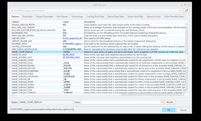

Hi Guys,
Using Creo 7.0.2.0 and EMX 13.
When I create a moldbase using EMX, and accept it, It creates a Style State VIS001, which is always wire frame. This is driving me nuts.
Anyone know how to stop this from happening?
I don't want any new style states created.
Creo 3 and EMX 9 did not do this at all.
Jay
Best answer by dunebuggyjay
Figured it out:
dunebuggyjay14-AlexandriteAuthorAnswer
January 21, 2021
Figured it out:
