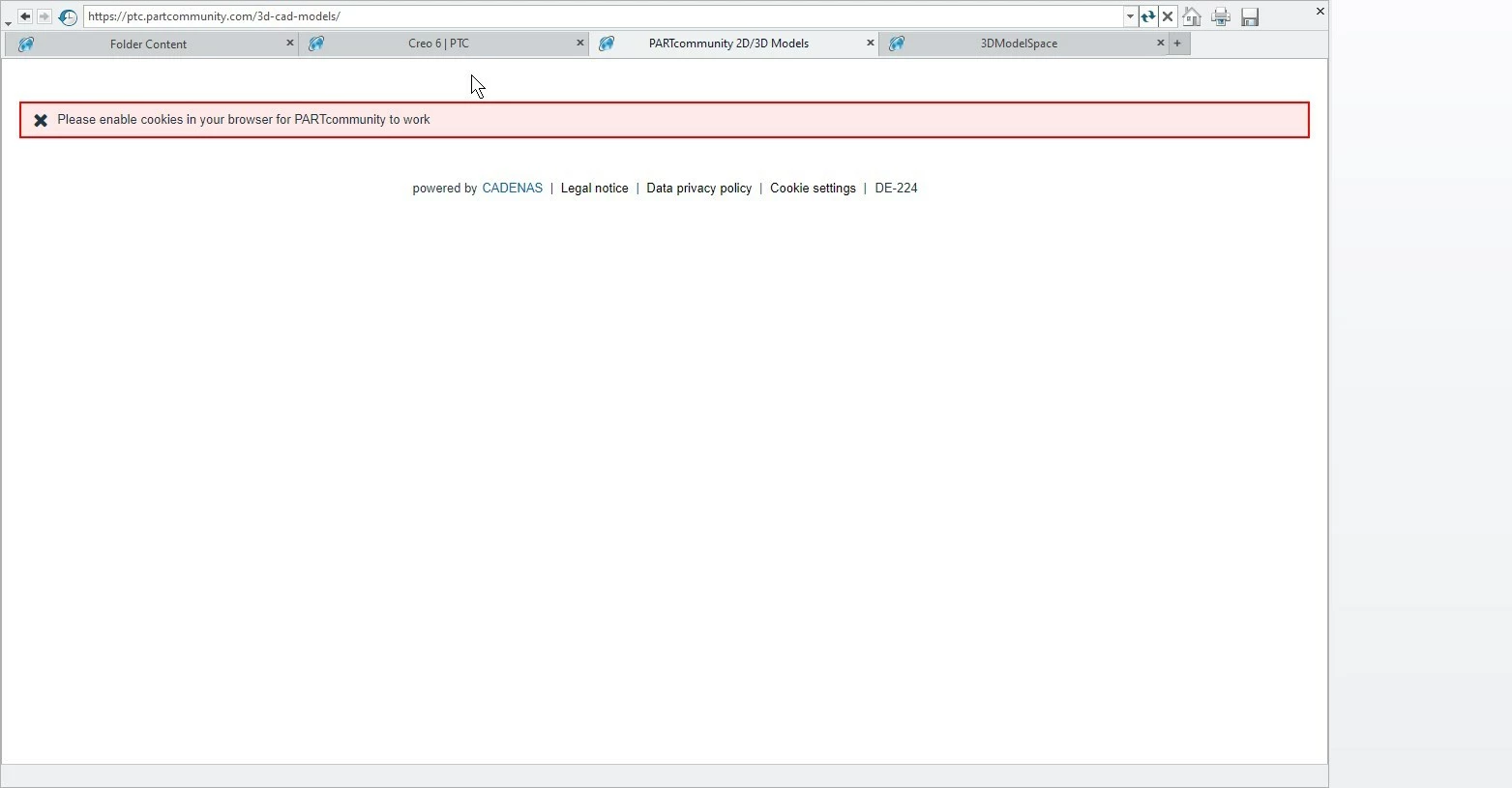

Enable cookies PartCommunity
Anyone have this problem? How can iI enable cookies from
m.sousaAnswer
June 4, 2020
The solution is to set windows_browser_type ie_browser on config.pro.
7 replies
March 13, 2020
Open the same web address in stand alone Internet Explorer and enable the cookies there.
m.sousa14-AlexandriteAuthor
March 13, 2020
How do I do that?
Open in stand alone internet explorer?
Thank you for your reply
March 23, 2020
In Internet Explorer, Tools, Internet Options, Privacy, Advanced, 1st Accept, 3rd Accept, and check Always allow....
