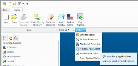

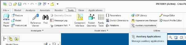

First you need to add the following line to your "protk.dat" file:
allow_stop                    TRUE
Next, from Creo interface access "Auxiliary Application" command.
You can do this from Home tab / Utilities oweflow / Auxiliary Applications (for an empty session)
or from Tools / Auxiliary Application in all other modes
On "Auxiliary Application" window select your program and then use the Start and Stop buttons.
For more information's about the registry file and all possible options read the "Creo Parametric TOOLKIT Registry File" Apendix on the toolkit user guide. For Creo 2 this is appendix D at page 1823
Jun 2, 2016 4:04 PM UTC
Hi Gabrial thanks for your valuable reply, I had tried the steps but it does not work for me.
     In some case if I updated my resource file or Message file from source it not working in same session, only after restarting creo takes effect.
With Best Regards
JKParthiban
