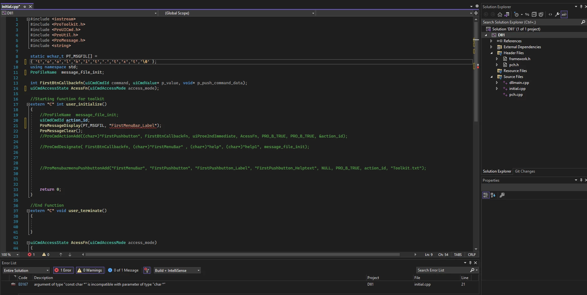

Hello all,
i am trying to write a simple program to display message in creo9.0 , i am using visual studio 2022, i am confused about the error in vs and when i manage to create a dll  the message is not displaying in creo as well , but same thing works for my friend. so frustrating, please let me know what am i missing here

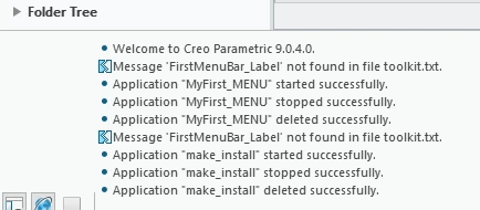

Hi,the display message string want wirite in the toolkit.txt.

The file and the label is already present in the toolkit.txt file and its location is also given correctly in protk.dat file as well.
