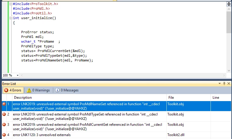

 Please help while compiling code in visual studio2010 i am getting below errror.
Best answer by YaroslavSin
Hi
Try this
Properties - C/C+ - Code Generation - Runtime Library = Multi-threaded Debug (/MTd)
Properties - Linker - Input - Ignore Specific Default Library = libcmt.lib

#include<ProToolkit.h>
#include<ProMdl.h>
#include<ProUtil.h>
int user_initialize()
ProError status;
ProMdl mdl;
wchar_t *ProName ;
ProMdlType type;
status= ProMdlCurrentGet(&mdl);
status=ProMdlTypeGet(mdl,&type);
status=ProMdlNameGet(mdl, ProName);
return(0);
void user_terminate()
January 9, 2019
For compiling and linking you using make file or project in VS?
January 10, 2019
I am using project .attached steps for creation of project in Vs
