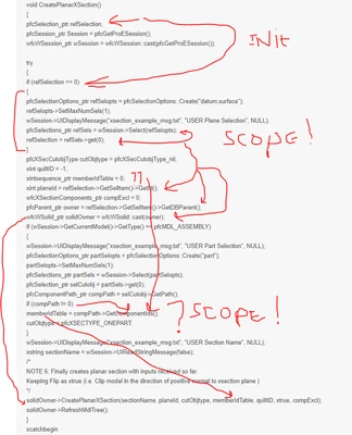

The code uses quite a number of pointers to object instances created in scope. In case an object gets destroyed when scope ends - pointers are pointing to undefined values, in case an object is not destroyed upon scope end the memory is leaked - not good either.
I would suggest to use Pro/Toolkit - the code would be much clearer and it is easier to see problems right away.
HIH.

this is not correct.
C++ will not automatically initialize a variable to NULL value after variable's declaration.

You are correct about variable initialization. I changed code but issue is still there.
I think, that is not root cause of the issue I am facing. I am able to select face which is asked by ->select() command. but application fails at
solidOwner->CreatePlanarXSection(sectionName, planeId, cutObjtype, memberIdTable, quiltID, xtrue, compExcl);
Do you find something wrong about solidOwner.
Your assistance will help me in long way.
