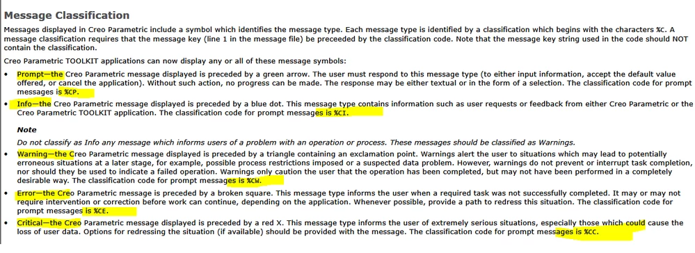

Hi all,
Does someone have a list of all !%Cx comment type that could be present in Creo trail files
You will find below some examples.
Thanks & regards,
!%CE
!%CEFeature regeneration failed.
Guess: ERROR
!%CW
!%CWWARNING: EXTRUDE_68 is entirely outside the model; model unchanged.
Guees: WARNING
!%CI
!%CIRegenerating OF02921607-AMO-E17 feature 54 out of 355 ...
Guess: INFORMATION
!%CD
!%CDLine 2 part 7397381: Model changed since mass props calculated. May need to recalculate.
!%CP
!%CPWARNING: Design intent is unclear in OF19018856-LAT-E03.  Use "Info"/"Geom Check" in Part mode.
FV_01
February 25, 2019
