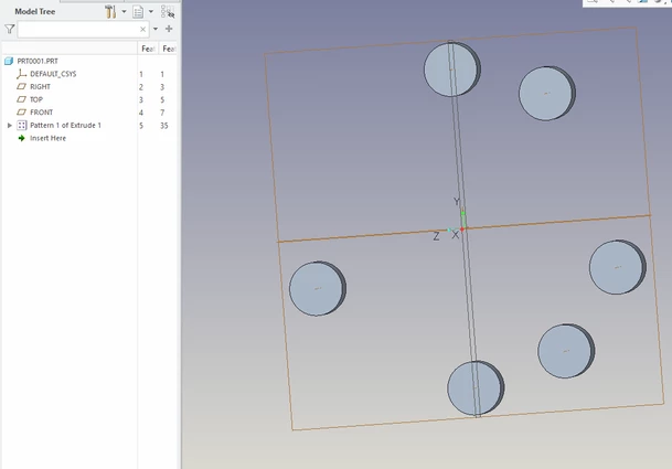

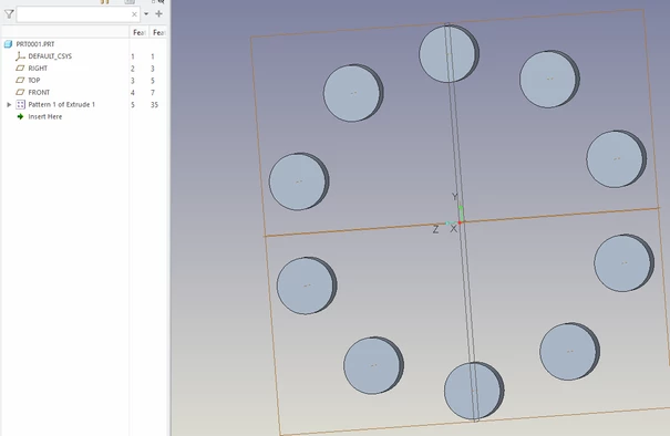

For example, I have the pattern created using Java OTK and FET:
Since I created this element using FET, I know that it has a certain structure, the elements of which perform certain functions.
But I could not find the element that is responsible for the functionality I need.

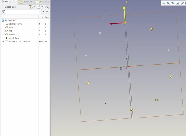

This is what I need:
1) disabling pattern elements.
2) the result that I need:
That is, I need to programmatically disable some of the pattern elements.
Thanks in advance!
Regards!
January 13, 2020
thank you for clarifying.
You may  try and extract the tree information and compare the pattern with versus without the excluded member.
