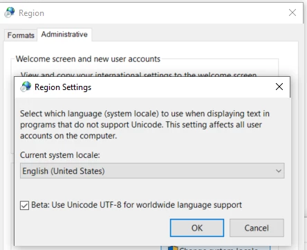

3. Change Region Settings (20250228_screenshot_1.png)
