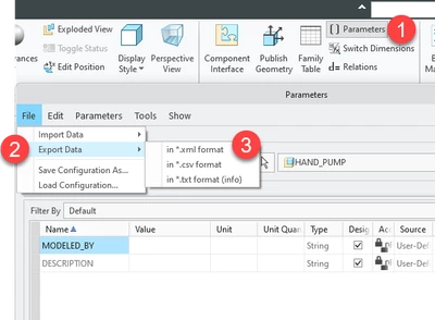

Hi @TP_10167633
Try the XML option to export/inport
