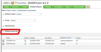

Hello, I was trying to find assosiated draiwn using REST API for a few days for now but didn§t succeed in it

This article on help says what i have to do but it never worked fo me.
https://support.ptc.com/help/windchill_rest_services/r2.7/en/#page/windchill_rest_services/example_CADDocumentMgmt_navigate_CADdocument_to_Drawings.html#
GET /Windchill/servlet/odata/CADDocumentMgmt/CADDocuments('OR:wt.epm.EPMDocument:191730')?$select=Identity&$expand=Drawings($select=Identity,Name,FileName,Version)
simply doesn't work
Help me please😢
June 30, 2025
After using the REST API for several days, I discovered an interesting structure in the database.
A drawing has a "References" endpoint, which allows me to find the assemblies or parts it references—this works without any issues. The link is even marked as a "Drawing reference."
However, even though the Windchill web interface has a "Referenced by" category, this category does not exist in the actual REST API.
