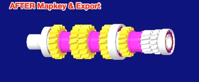

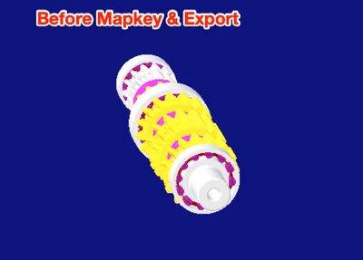

18-Opal
March 27, 2020
You can always record and run a mapkey to get that orientation ... then export accordingly.
In CREOSON you can do this quite easily : note this was code executed in the CREOSON Playground.
// note: get connection first. :)
let intObj = new creo.InterfaceObj();
// set the mapkey value
intObj.script = "~ Select `main_dlg_cur` `igToolbar_AncestorIGT_IGT_GRP_inh397369119.proe_win:casc340798662`; ~ Close `main_dlg_cur` `igToolbar_AncestorIGT_IGT_GRP_inh397369119.proe_win:casc340798662`; ~ Command `ProCmdNamedViewsGalSelect` `Standard Orientation`;"
// execute the mapkey
intObj.mapkey();
// set export type
intObj.type = "TIFF";
// export the image
intObj.export_image();
Hope that helps.
