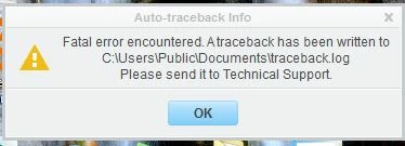

First start up
I installed PTC Creo and when i try to open the program it will start to load and then stop and say "Fatal error encountered. a traceback has been written to C:\Users\Public\Documents\traceback.log Please send it to technical support." what should i do?
InoramAnswer
Jul 20, 2014 5:52 PM UTC
on your computer look where you installed it, something like
C:\Program Files\PTC\Creo 2.0\Common Files\M100\text
in the text directory if you do not see a config.pro file, then make one with notepad and put
graphics win32_gdi
in the text file and save it and rename it config.pro. and make sure it is config.pro and not config.pro.txt

Jul 20, 2014 1:24 AM UTC
What kind of video card is in the computer you are running it on?
Jul 20, 2014 5:37 AM UTC
its a one year old laptop. its running of the cpu graphics i beleave.
Jul 20, 2014 6:41 AM UTC
try putting graphics win32_gdi
in the config.pro

Jameson,
Which graphics card do you have on machine?
Which Datecode of Creo 2.0 you installed on machine?
You may try options in earlier post at.
http://communities.ptc.com/thread/54430?tstart=0
