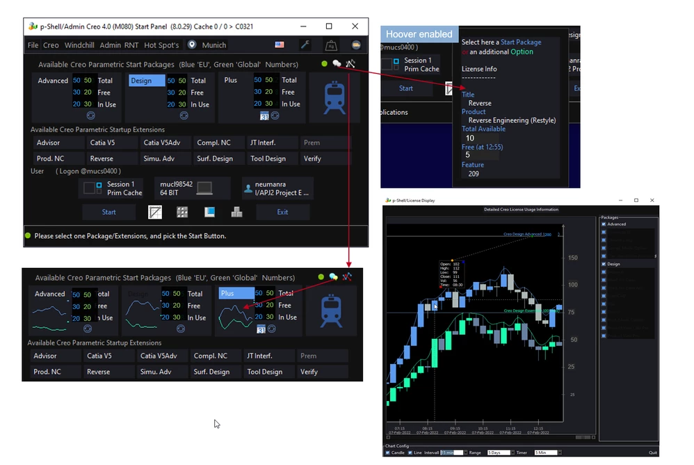

Some customers would like to see the status of Creo licenses.
We explain that you can see the quantity in use and the total quantity through ptcstatus.bat.
Administrators are burdened with installing creo to use ptcstatus.bat.
We try to show you a visible licensing situation using C/C++, C#, etc.
We would appreciate your feedback on how it can be implemented.
Thanks, Warm Regards.
SeonHo Cha.
P.S.
lmstat -a 7788@myServer -c -i over socket communication is difficult to analyze.

Hello Cha,
all user can see the amount of total and available licenses Live. On hoover, if enabled, the user will see what is part of the license, and the current status. If they enable the simple draw, the last 8 hours as diagram will be displayed. Supporting Global and EU License Types (Thanks to PTC for that .....)
Detailed View is Line/and/or/Candle Display  with Interval, Range and Timer Settings.
Candle will show Open/High/Low/Close/Volume like a Stock Chart 🙂
This is a Client/Server communication, all Creo License Data is saved in a DB.
The Numbers in the Images are Fake (modified in PP). Other thinks may also be grey/blacked out 🙂
Send a Mail if you want a Movie ....CreoLiveLicenceView.png 🙂
