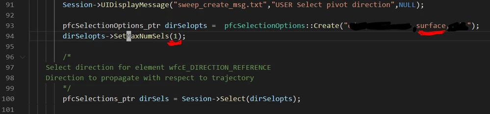

This is how to limit a number of possible selections to 1:
  • follow the example in 'Common Files\otk\otk_cpp\otk_examples\otk_examples_feat\OTKXCreateSweep.cxx'
  • make sure "surface" option is specified and max number of selections is set to 1.
